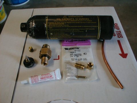

Parts I used:(see first pic)
part # A-22 from the homedepo plumbing section. This included 3 parts: The nipple, coller, and a little tube (this little tube is not used when using copper pipe, you can just set this asside).
Thread sealant
A little teflon tape
My old on/off valve (with valve knob and burst disc removed)

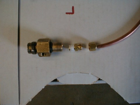

The second pic shows the order in witch the parts go together: The valve, the nipple with a little teflon tape on the valve end, the coller, and the copper tube.
First, I screwed the nipple into the valve and tightned nice and snug. When I tried to attach the tube and coller I found that the tube did not stay in the coller very well after tightning it down, I decided to go ahead and solder it in place.

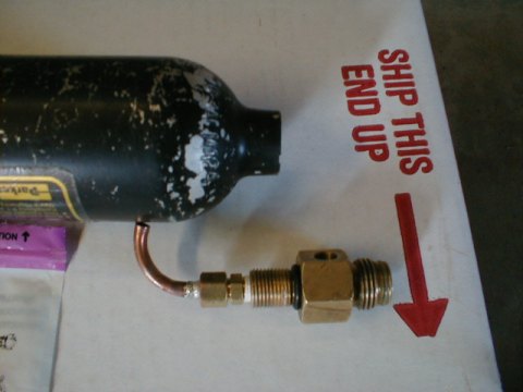

Alignment: This is probably the second most important part of the project, if you don't have your tube aligned so that it points up when installed onto your gun, you will have wasted your time compleatly. Insted of and anti-siphon tube, you might end up with a siphon.
To align properly, screw your valve (with or without the tank) into your gun's ASA and put a mark on the top of the valve, this is the direction you want your tube to point when finished. Note: This means that your tank will only work properly on YOUR gun or a gun witch happnes to line up properly.
Now that you know what direction you want it to bend, now, just bend it. Idealy the end of the tube should just touch where the straight cylinder porting of the tank meets the round sholder at the top. Mine turned out to be a little long, because of this it may still take in a little bit of liquid on a full tank.
The third pic shows the compleated valve/tube assembly ready to be installed. You can see that the tip of the tube is a little further down the tank than it should be, but I think it will work just fine.

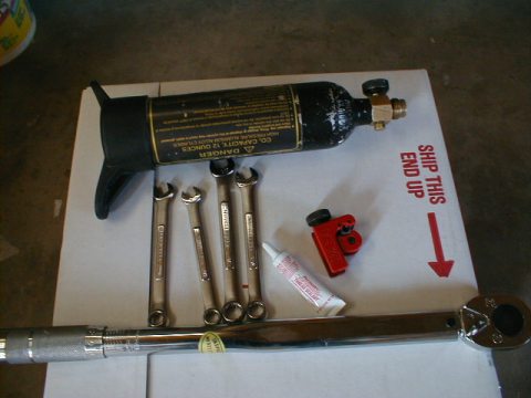

Finaly, I installed the valve back onto the tank, THIS IS THE MOST IMPORTANT PART OF THE PROJECT!!!!!
If you do not install your valve properly it may sperate from the tank when trying to remove it from your gun. I have heard of a news report inwhich a lady was killed by a tank witch seperated from its valve. THIS IS NOT SOMETHING TO HALF ASS!!!
Before screwing the valve on, I checked to make sure everything would fit in and thread properly. Then I applied some thread sealent and torqed it down to 30 ft-lbs, this might not soud like a lot, but too much could damage the threads.
The last pic shows the compleated tank and the tools I used during the process.
All in all it was a pretty simple project. I probably spent more time with this writeup than I did actualy installing the thing (even while pausing to take pictures).
